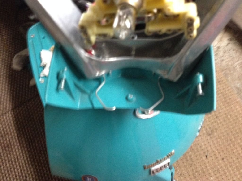

Can I just check please?
Post  mickey c on Fri Dec 23, 2016 2:53 am
I am king of the school boy error & couldn't see the set up in the thread suggested. Before I press on can I just check that my logic skills are correct? Is this how they should look ?

Post  trotsky on Fri Dec 23, 2016 12:38 pm
Hi Mickey, yep that's spot on. As well as carb springs for tension & to push the headlight thru the rim i think i also used a "w" top spring clip as on S3/GPs etc on the top of the rim & headlight, that helped balance the tension top & bottom if that makes sense?.....Looking good sir  Wink  ...Steve

Re: headlight help please
Post  mickey c on Sat Dec 24, 2016 8:34 am
Thanks very much for confirming that Steve & the positive comments. Thanks also for the tip about a top Spring, I did wonder about that & feared it would be a bit like a search light of the sky!

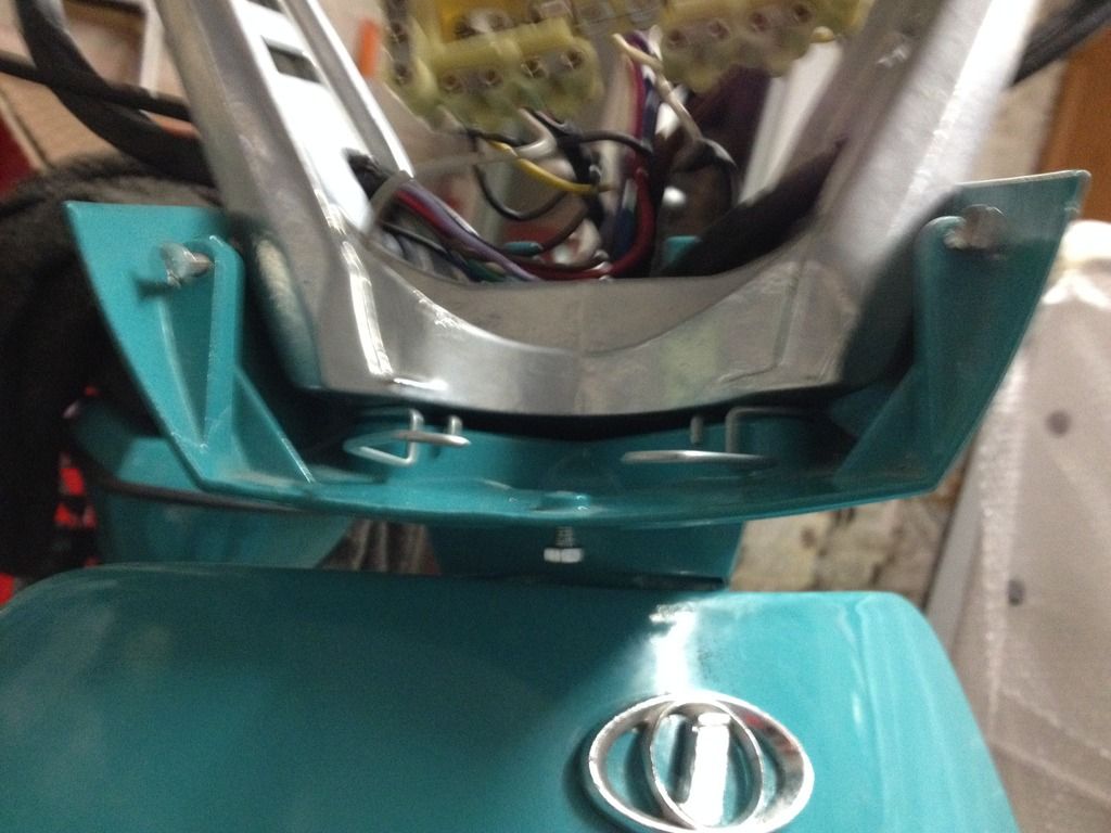

Post  Snails on Fri Jan 27, 2017 2:46 am
Something seems strangely wrong in this picture Very Happy Very Happy Very Happy Very Happy Very Happy Very Happy Very Happy
Post  mickey c on Fri Jan 27, 2017 5:20 am
yeah the school boy error was not the wrong bulb holder, merely it being upside down! Embarassed
in my defence, I have made many worse school boy errors than this!
