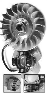

Thackers wrote:What would the benefit be? You can still get plates etc for the luna range. Or am i missing the point? The price would have to be good bearing this in mind.
I would have thought a 12v conversion would have been a more needed upgrade (apart from a bigger cc top end Very Happy )
As if by magic Smile
http://lambretta.co.uk/catalog/product_info.php?products_id=6174
