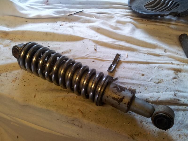

First job was to get the engine out and the engine bolt proved that no grease in 40 odd years doesn't make for an easy job but eventually the old favourites of a mallet and a drift saw the bolt pop out. The rear shock absorber was the next to be removed. Having the scooter on the bench meant that access to the bottom bolt was easy from the engine side but it was the top mount with its "past its best" bush that proved hardest to remove. Eventually she pop off.
The shocker isn't in back nick but could do with new bushes and a paint job, but then again it may just be easier to replace it with a new item.

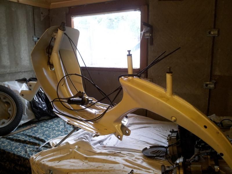

With the shocker off and the engine bolt out the engine dropped and it was easy enough to manoeuvre out of the way. Why I hadn't bothered to put the scooter on the bench 2 years ago is beyond me. A quick look over the engine casing for cracks or defects didn't reveal any. Amazing to see the engine so close up, you realise how miniature it really is, especially the carb!
The legshield screws all came out easily enough - they have been replaced at some point as they were a mix of allen head and Phillips head screws. The rear brake pedal was released from its non existent cable and removed. Its in good order but will need re-fettling.
I was annoyed with the rear frame badge as one of the two prongs broke when I gently removed it. I realised that whoever had painted the scooter in its pearlescent white coat had paint over the 2 plastic lugs that hold the badge in place. Net result was that as I gently prised the badge up, one side came free easily enough, the other was effectively stuck in place and the badge broke. Bugger!
All of the cables had been snipped at the engine end and were easy enough to pull through and loop together. Handle bar bolt undone and the handlebars came off easy enough. Just the forks to drop and then the legsheilds can be removed. I don't have a tool for removing the two bolts that hold the fork in place at the top so that'll need sorting - for now though, the forks stay in place.
