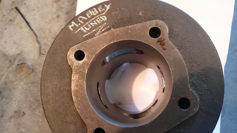

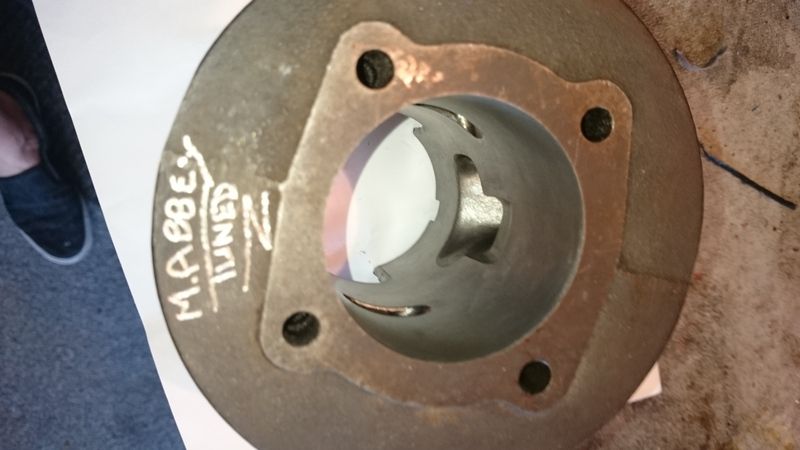

O.K Things are starting to move at last Embarassed I've got the barrel and piston back from Mick Abbey with some windows cut in the piston a little shaved off here and there and a nice boost port in the barrel with work done on the transfers etc.
I've just to work out some packers/spacers to make the carb avoid the cables and chaincase side. Then it's back to Micks, to Dyno the bike as it is now, to establish a benchmark to see the difference when on the Dyno with the reed block e.t.c fitted. Further plans are to fabricate a exhaust to make the most from Mick's work, which he already has drawn with my input of a heat guard to stop me burning my trousers!!!!

Post  Snails on Tue Aug 18, 2015 2:26 pm
Nice. Thanks for the pictures. Smile
That exhaust sounds interesting.

Post  daz.h on Sat Aug 22, 2015 10:34 am
arm wrenching power Thackers:)
great pictures and information, hopefully, mick will get it a real flying machine.
I saw some of his work on youtube on a T5 cylinder.
it would be great to get a proper cylinder like yours cast in alloy and nicasil lined.
