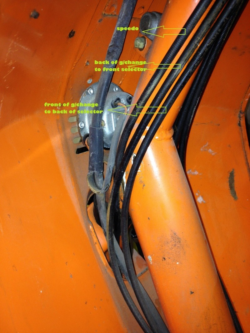

might help someone, cable set up on original un restored cometa.
[img][/img]

the g/change refers to the hand gear change.

Thanks Daz, that's just what I am working on at the mo so very timely
