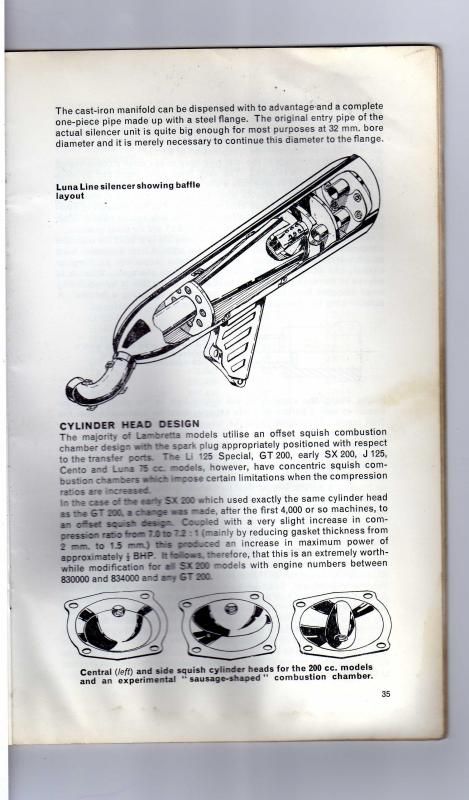

Post  Scooter Paul on Wed Aug 27, 2014 8:42 am
Is anyone able to scan and post here the relevant bit from 'The Lambretta Tuning' book showing how to modify the standard Vega exhaust for better flow. I've acquired one that requires opening up to repair the main tube so I thought I'd have a go at getting it to breathe better for a 125 conversion. Does anyone know where I could get a copy of the whole book? Was it written by Mike Webster?

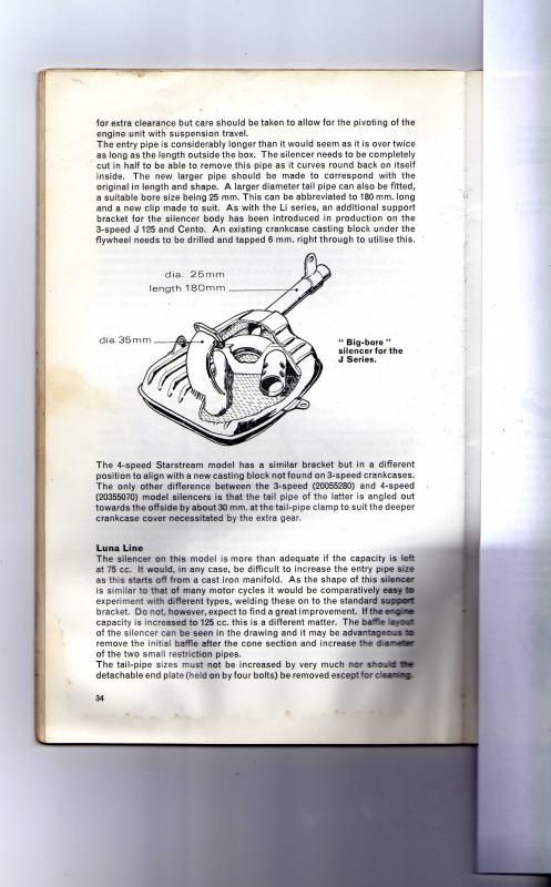

Post  Thackers on Thu Aug 28, 2014 3:52 am
Here you go Paul
The book is by Ken Herlingshaw and gives quite a good tuning selection on the Vega inc the increase from 75cc to 125cc. I hope this helps your exhaust quest anyway. Cheers.
Re: Exhaust mods
Post  Scooter Paul on Thu Aug 28, 2014 4:56 am
Excellent! That brings back memories. I'll give it a go.
