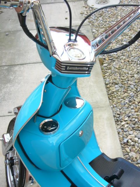

Post  Thackers on Tue Jan 13, 2015 1:46 pm
Mickey, here's a few snaps of my Ld toolbox, it has a smaller clock in it now. If I can help in any way just ask.

Wow - Thackers your scooter looks ace! I'm looking to do a very similar scooter (i.e. colour and toolbox) but I wont even get close to looking that good.
Also thanks very much for the photo, that is really helpful, I was trying to put it much higher and will now drop it this height.

Post  Thackers on Wed Jan 14, 2015 12:51 pm
Embarassed Thanks for that, very kind of you to say so.
Ed, no I didn't cut the tunnel for more space, though that might be a good idea you would have to close up the tunnel on the bottom section to stop things falling down

well done thackers, that looks like its ment to be there.did you have to cut it much to get it to fit.
boozee
Posts : 65
Join date : 2013-12-03
Re: Legshield toolbox
Post  Thackers on Thu Jan 15, 2015 3:40 pm
boozee wrote:well done thackers,  that looks like its ment to be there.did you have to cut it much to get it to fit.
Cheers, no I didn't cut it, I extended it in depth. The LD box isn't very deep so the sides needed to be longer then cut to shape. I used card taped to the box then scribed along the legshield to get the true shape ( a trick from my joinery apprenticeship) then used the card to mark out the sheet tin, This was then glued into place with a rivet either side to secure it in place. Then filled and painted. A bit fiddly but worth it in the long run. I covered the inside of the leggies to stop them getting scratched whilst trying to get the final shape.

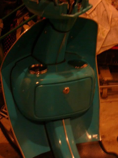

Post  mickey c on Sat Feb 21, 2015 7:00 am
This is full Thackers copyright!
Although I wished I'd done metal work at school! It's not totally symetrical & the rubber trim will need to hide a few foibles but for £40 & a bit of time, I'm sure the storage space will come in handy!
Thanks for the pointers Thackers
mickey c
Posts : 182
Join date : 2014-12-01
Post  Thackers on Sat Feb 21, 2015 9:43 am
Looking good Mickey Cool I removed the two inner stays on mine so the space went right back to the legshields. How are you planning to fit it in place? I ended up with 2 small right angled brackets riveted to the top which bolted to the centre beam via captive nuts (all inside so all you see is the top of the rivet) then some black silicone along the bottom of the rubber to the leggies. You might want to consider the fitting before final paint. Then to protect the back of the leggies inside the box I stuck on some ether foam. Keep up that good work Very Happy Very Happy Very Happy
