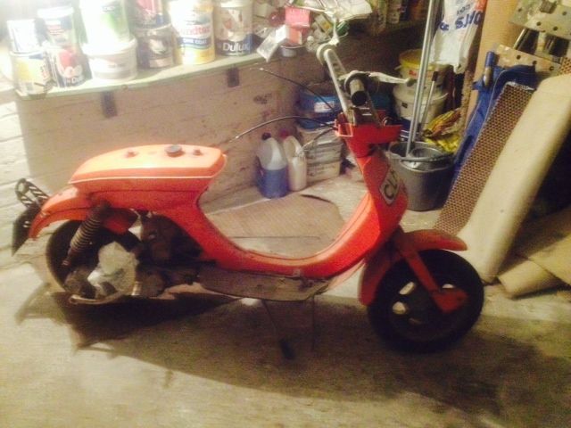

Its taken longer than hoped or expected but finally stripped and rust treated my 1st Luna project. It started at this:
The photo doesn't do justice to the rust, most nuts needed drilling out and getting the engine bolt out of the silent blocks took about a month and countless new drill bits. I got nowhere and so had to find a firm with a magnetic drill (whatever this is?) And they got it out.
Finally got it blasted and think I will keep the powder coat finish as quite pleased with it. This leaves more money for the engine which having the silent blocks removed whilst I source new bearings.[url=http://illiweb.com/fa/pbucket.gif
[/url]
Looking forward to getting it all together. Got a few ideas but general plan is something I use regularly and not get overtaken by byclcists !

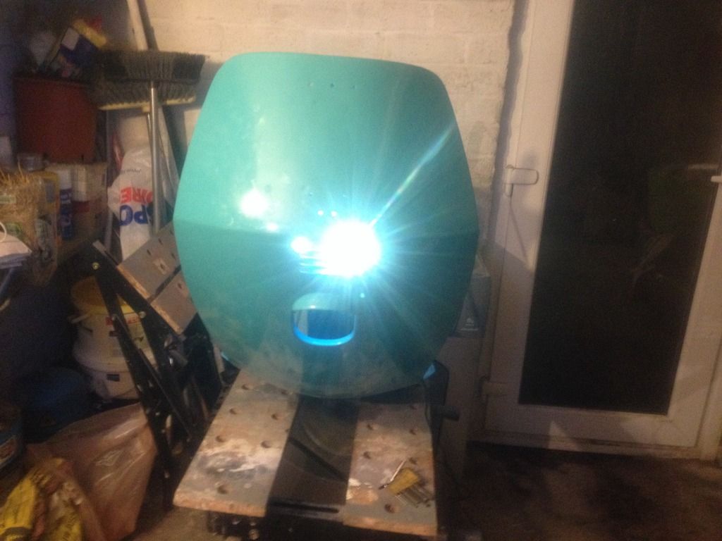

I have bought a sunny stator which us weird! Basically 6v except headlight which is 12v. I'm hoping there will be enough juice to run both lights on the 12v circuit so bought cheap LED unit. Quite pleased with the brightness but also think I can get a bigger / more LEDs in, if I can find 1.
mickey c
Posts : 176
Join date : 2014-12-01
Project
Post  Admin on Mon Mar 02, 2015 1:41 am
Lights look bright enough to me
Posts : 369
Re: Vega project
Post  Scooter Paul on Mon Mar 02, 2015 1:45 am
Ah! But you've hooked it up to a battery- DC. If you run straight off the stator it'll be AC which may not be as bright. I've a LED rear light on my AC powered series 3 and it works but not that bright.

Not sure if you're on Facebook, but if you are and you're on the Vega page. I posted up a photo of my LED conversion I've done a few days ago. Running on the original 6V Stator and Flywheel, not only has my rear light and brake light improved 100% but my headlight has as well. Judging by mine, I'd say you'd have no problem.

I don't face book but I'll ask my lad to show it to me. Adam, can I ask what LED unit you used please? I just got a cheap thing off Ebay which is doing a job but is very small, I reckon I could double the number of LED's in the Luna back light, it is surprisingly large.
mickey c
Posts : 176
Re: Vega project
Post  Adam Sleight on Thu Mar 12, 2015 2:35 pm
I used the original Lui back light housing, then made a separate bracket to fit inside the housing which I mounted the LEDs to.
