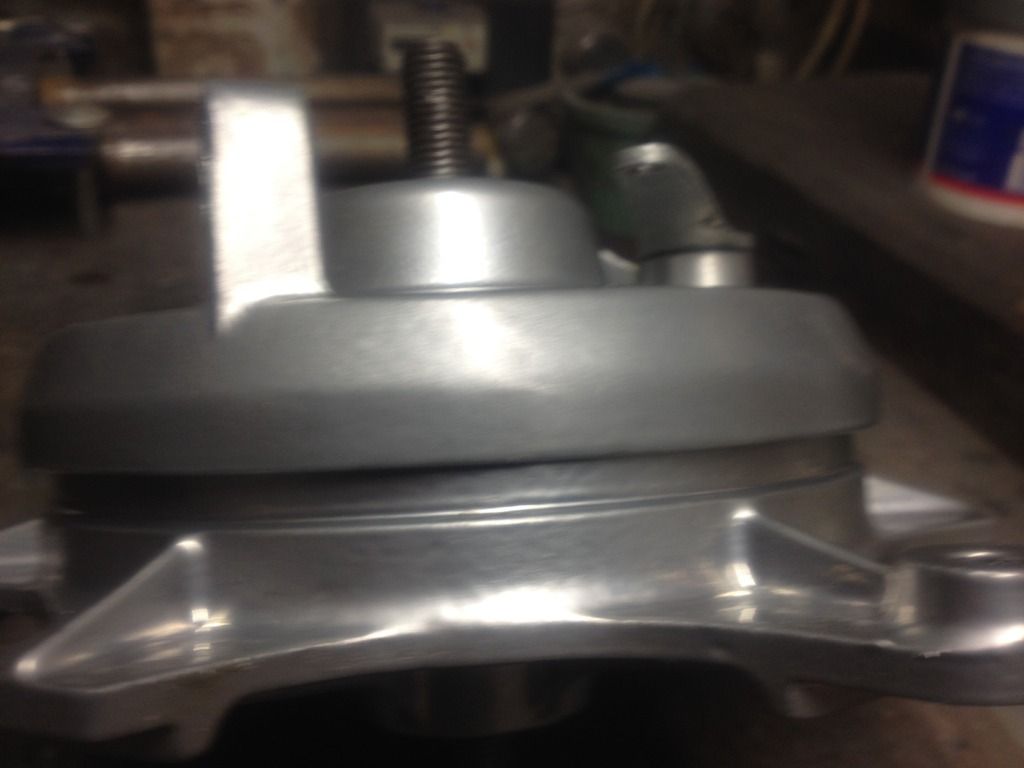

I've spent another couple of nights on this front hub and am still stumped.  I did note the thread on the spindle is longer 1 side than the other so tried fitting it both ways.  I spent ages getting the brake shoes but then couldn't even get the shoes into the hub, which looks like I will have to remove the protection plates from the shoes.
However even with no shoes in the back plate, I cannot get the hub to close, see picture 2, is this correct to have 5 - 10 mm gap?

Are you sure you have the right shoes for the hub you are using?
Picture 2 - It does not look right to me
Picture 3 - Its the spacer sticking out of the seal that is preventing your two halves from sitting properly together if you ask me.

That's 1 question answered! I swapped the spacers round and now the hub closes and spins nicely - yea!
But the spacer now protrudes approx 5 mm proud of the oli seal on the hub! Should it do that. I'd do quite a lot for sticky or someone to do a luna line equivalent !

Yeah it should stick out a bit otherwise it would not be a spacer and the two halves would bind together when tightened yeah?
Re: front hub re-build question
Post  wack 63 on Fri Mar 27, 2015 2:12 pm
You need the spacer to stick out on the hub side as the speedo drive goes on then the half nut .With no spacer the speedo drive would be trapped and not turn.Have you painted/coated the lining on the inside of the hub as it looks the same ?

Thanks all, I think I'm getting there thanks to this assistance, hub now closes without shoes, so will sand powder coating of & cross my fingers!
