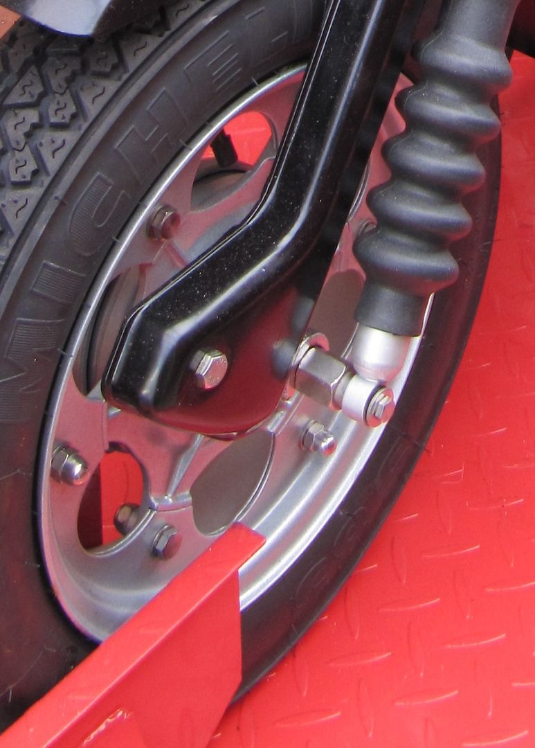

Remembering all the potholes in Ireland at Eurolambretta ´98 made me thinking about an improvement on the front forks since I would like to use the Cometa next June to go to Killarney.
Some time ago I purchased an old stock of Lambretta parts from a dealer in Swizzerland, including some strange (at least to me) brackets - but now I think I know what to use them for:
Have you seen these before?

i agree some extra buffering is required on the front end.
not seen them before, and i dont like the look of the outside nut, it has a shouldered edge, where it should fit into the fork link.
use it by all means, but i'll be sticking to the other damper set up.

The pics show just the "beta" setup for aligment of the upper fixings.
The brackets have a welded in ring fitting into the forklink (where the nut used to fix in).
Seems I have to use a longer spindle as well. Will Post a pic of the brackets alone later.

You need one of Daz's super dooper extended front spindles with screw in damper studs. There the best way forward Cool

Here's my swiss version:

this was what thackers is on about.
i dont have any left now, i will have some more in the new year.

they look like the jaison's damper brackets like I had'em on my DL
